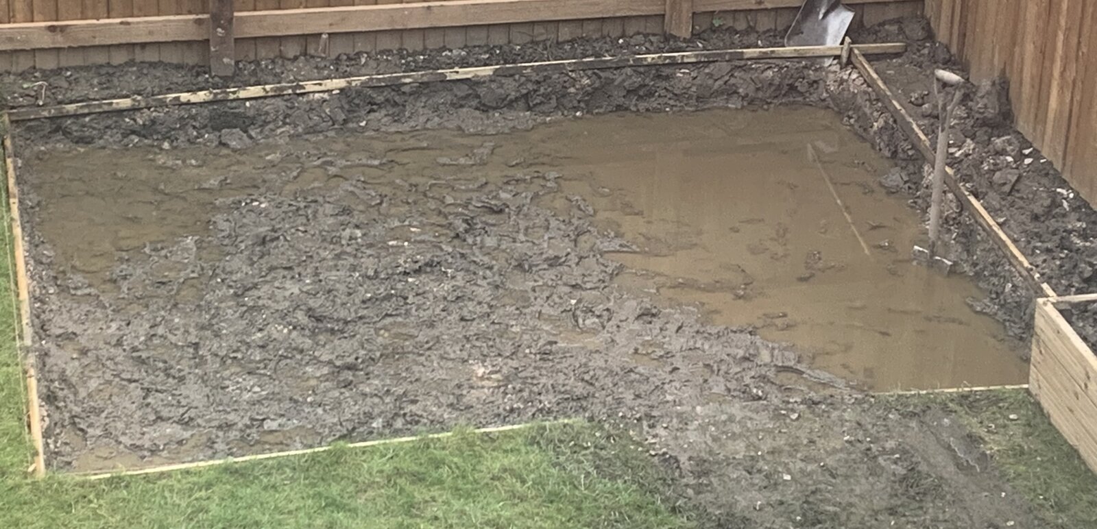

Hi all, I have dug out a space for make the new shed. However , after a few rainy day , there is a waterlogged in the duged area .
How could i move onto the next step to level the base and laying subbase if the water still there ?
Thanks for any advices~~

How far down is the clay subsoil?

It's normal building practice, when a foundation is flooded, to give the water somewhere even deeper to go, from where it can be more easily pumped or even bucketed out - old chap.

Simply because it will be very difficult to get the water into the bucket, and even more difficult to get all the water out, old bean. Dig a small sump alongside, and all the water will very quickly drain away, into it, from where it can easily be removed - simples for most people.

The situation is, what the situation is at present - Odd Man, and the easy way to drain the water out, is to give the water a deeper hole to run into. Standard hydro engineering practice.
