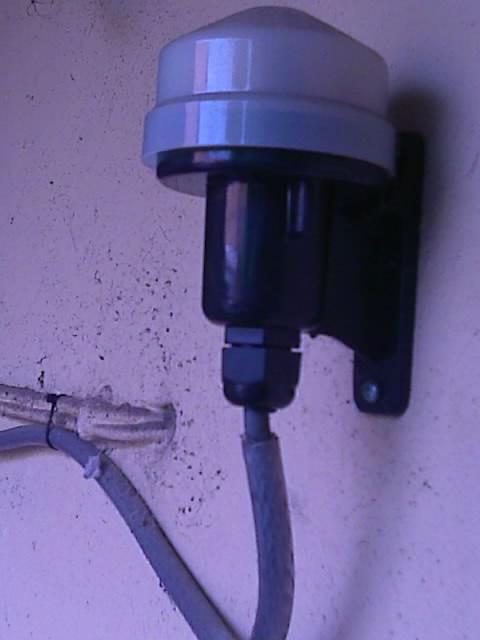

40 metres of this given to me by a neighbour. He has had it for some time.
View media item 4712
View media item 4713
View media item 4714
It is clear plastic coated, metal meshed under that, then 3 core, earth, brown and blue surrounded in plastic/rubber.
Is there a remote chance, :rolleyes: that I could use it to carry power, from a new CU to a smaller CU in a new workshop I am building. A qualified Sparky would carry out the work i hasten to add.
Or is it destined for the local scrap yard?
Yep SY flex.
What is the proposed route? It isn't really very good for being installed outdoors.
Also, it is difficult to guage the CSA of the conductors, so it is hard to say wether it is suitable really.
"not suitable as a replacement for SWA though"
And that means..........................?
Sorry RF we posted at the same time.
The route?. Yes, about 15m outside, under a concrete path then up conduit into the workshop.
Then no it is not suitable.
SWA cable is what you require, as TTC was inferring.
Thank you both for your prompt replies. SWA it is then.
