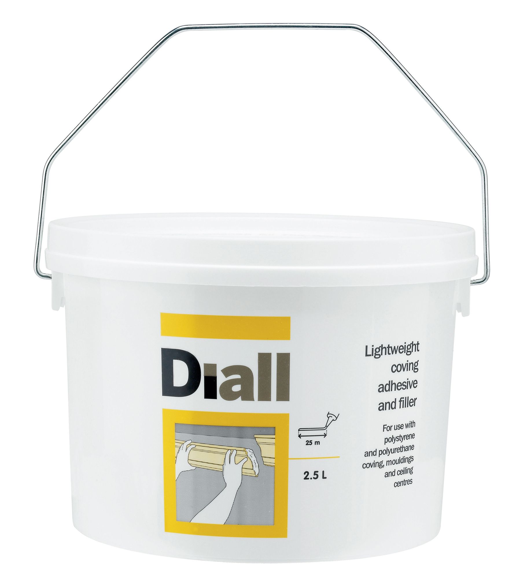

I have used this in the past, but reviews are not good. Unless they changed the formula... I have found it great for filling shallow areas and dead easy to sand to a really smooth finish.
