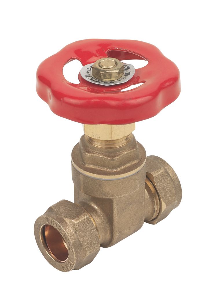

I guess by tank you mean cylinder in the cupboard. The pipe that comes out from the top, will be your hot water feed to your taps.
There should be a valve on this pipe, normally a gate valve, that will stop the HW flow to the tap.
May be a good time to fit a isolation valve.
Hope this helps Rob
Pic would be good
If there is one of these on the hot pipe feeding the tap then you can simply turn this using a screwdriver
ae235
Failing that, there should be one of these
ae235
Either on the pipe coming right out of the top of your cylinder in the airing cupboard and/or on the pipe going into the very bottom of your cylinder. Closing either of those should stop the hot water (there will be some left in the pipe that will need to be run off first by opening the tap).

There will be a number of those gate valves, you need to make sure you close the correct one, either the one at the very top, or the one at the very bottom. There should be 2 more pipes connected to the cylinder between the pipes you are interested in, don't alter those.

It won`t stop completely - they all do that , guv - as long as it`s not belting out . AND you let the hot cylinder cool completely ,ie. use the water for a bath and don`t re heat it . You`ll be able to work on the tap in the kitchen without being flooded or scalded ;)
