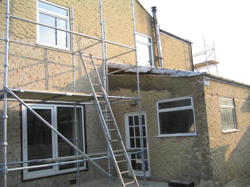

Currently extending my house and it looks like I won't be able to re-site my old Worcester Bosch 12/14 oil boiler so I guess it's time to buy a new condensing one. Had one set of plumbers out who seemed liked good guys but they only fit Worcester Bosch boilers and I'm sure I've read mixed reviews about them on here. Looking at a heat only boiler around 18/25kw, any thoughts on Worcester vs Grant vs Firebird (or any other recommendations for that matter). Thanks

That's pretty much what I'd heard :( What's your thoughts on moving the existing boiler, the attached picture shows that it is currently sited in an attached 'lean to' but there's a two story extension being added to the entire side of the house. If it could be be relocated my concerns are that I would no longer have the big silver chimney taking the soot away from the house and as it will be rendered white/cream then it would make a right mess of the building. Are there kits available now with soot filters so all that's emitted is steam?

Answer to most is no, I'd always replace now, moved a couple last year never again, sourcing old flues etc wasn't worth the hassle

I suggest external oil boiler.
Grant is the quality product but I've also installed Warmflow and they
seem reasonable if a little unfinished.
I suggest external boiler. Job done just connect up the heating
pipes, electric and away you go. Don't mess about with old boiler
more hassle than it is worth. Especially since you have that monstrosity
of a flue outside.

Unfortunately I can't fit an external bolier as there's no space immediately outside the new structure as I need room to get a double pram around (twins!!) and only have about 4 feet of space to spare.
If practicle, I could site the boiler on a concrete pad in the garden about 20 feet from the house where the oill tank is also located but is this

I have pictures of just such an installation we did about 2 yrs ago on my web site blog.
We located a Greenstar Camray external 30ft down a garden, near the oil tank. But not near enough to be against OFTEC regs, before you ask.

An external boiler can be away where outside. Front, back or side of house.
It would be approx 2ft wide. You can still integrate an air source heat pump later. It doesn't have to have a thermal store.
