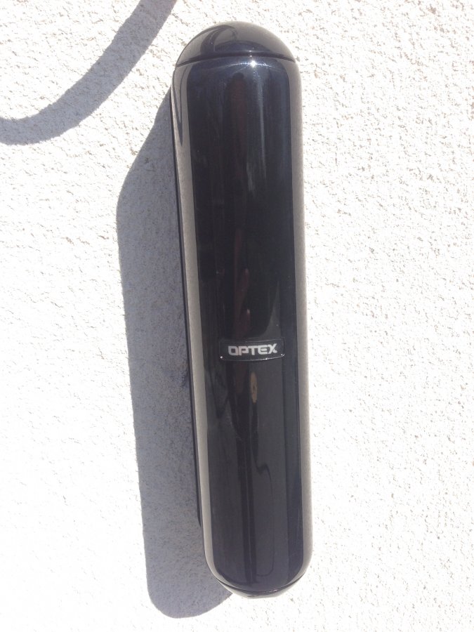

Also I saw the following external sensor in the garden of one house. Is this a proximity / perimeter sensor? If so, what alarm system does this belong to or do all alarm systems offer them?

That detector in the picture comes as a pair. There should be another one in the direction that is facing as there is usually a transmitter and receiver. This sends multiple beams which when broken trigger a relay. You can connect this to your alarm using the same cable assuming its complete.

1. Well its a break beam detector so only send a narrow beam between transmitter and receiver which triggers when broken.

I'm not sure that you've understood the beam - inside your Optex device there will be (say) some high power infrared LEDs and lenses that "shine out" of the case through the plastic. Somewhere else, there will be an identical-looking unit that contains IR transistors (receivers) and lenses. The internal lenses are "aimed" at each other so that the beam(s) of IR light from the transmitter go directly to the receiver. Physically, this could be straight out, away from the wall, or sideways, along the wall. Anything breaking the beam will cause the receiver to trigger its alarm relay and this is connected to your alarm... If you were Tom Cruise, you could get special glasses or an aerosol can and see the beams (but not in real life!!).
The GJD device is a PIR - PASSIVE Infra Red detector. This doesn't emit anything - it only looks. PIRs are fitted with with many lenses that focus the IR emitted by warm objects (generally, living things) onto a single sensor. These lenses create "looking lines" that are often (wrongly) referred to as "beams". They are NOT beams as the device is passive. When a warm object passes across one of these looking lines, the IR creates a "flash", and therefore an electrical pulse, on the sensor. The PIR's electronics counts these pulses as the object crosses the looking lines and triggers its alarm relay at the appropriate count.
Use the active beams (Optex - other makes are available) as an invisible barrier for perimeter detection. Use a PIR (GJD) to detect people (or animals) in an area.
You can use these devices with (virtually) any make of alarm. The only time that you need to stick to a particular manufacture's detectors is if you are using wireless, as the radio signals are all proprietary (another good reason for not using wireless!!).

Which is better..? - PIRs cover a wide area whilst beams are more like a fence. It depends on what you're trying to detect and where it's coming from. Also, think about what could cause false alarms (animals, plants, passers-by...). A false alarm is like "crying 'WOLF!'" and you'll soon ignore it going off.
