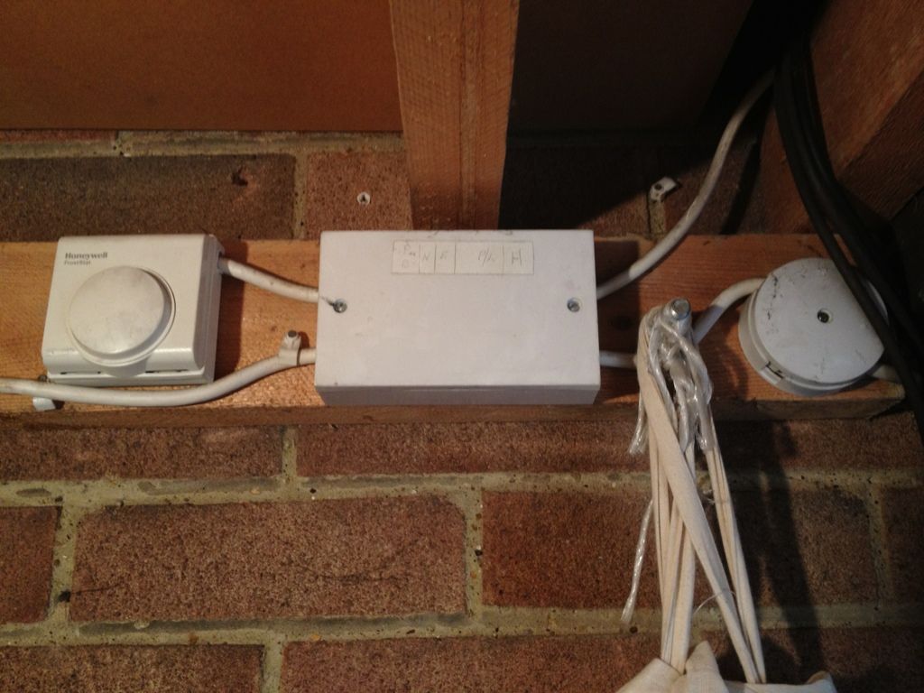

Its actually a Homexpert THR872CUK which is the same but different branding. Any help would be appreciated.
The following images:
1. Diagram of upstairs wiring
2. Upstairs wiring box
3. Close up of above
4. Programmer upstairs
5. Downstairs wiring (where boiler is located)
6. Labeling of above fascia
7. Downstairs wiring closeup
8. Downstairs Bolier pump wiring
Programmer/cylinder+stat is located upstairs, the bolier is located downstairs. The 2 port valves and it's additional wiring box is located in the loft.
Central Heating package consists of...
Potterton Kingfisher 2 RS100 Boiler
Open Vented Cylinder (Thermostat) with immersion Heater (Airing Cupboard)
S PLAN
2x Honeywell 2 Port Valves
Honeywell ST6300A Programmer
Fernox TF1
grundfos Alpha Pump
lockshield Valves Honeywell VT117E/VT200 & draytons[/img]
I have no idea where your cables go - there is no standard colour allocation of cores in heating installations. Even a green could be used as a phase wire.
However, you are in luck because I'm a qualified electrician as well as a Gas Safe dom/com. You can wire your CM927 to the ST timer, or to the other end of cable running to it.
The live and neutral in the ST timer are labelled L & N, run additional cables from here to L and N on the BDR relay box. You then take the cable out of pin 4 in the ST timer, and wire it to B in the BDR. Run a new wire from BDR terminal A to the ST timer terminal 4.
Job done.

Simond you are 5*****! Just wired it up and testing it as I type. All looks well. :) I bought the Homexpert THR872CUK from Amazon (wanted warranty/amazon service), its very similar to the CM927. Although with this model the front flap comes off and with the CM927 it folds up, minor gripe...
Thanks again for your help/input.
