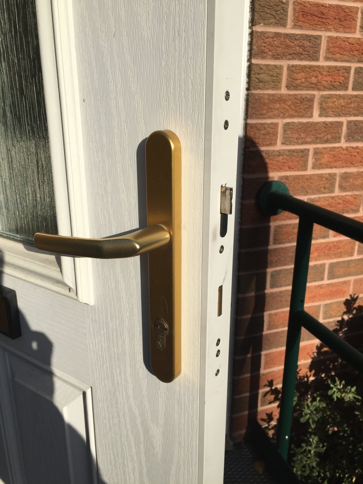

The outer door handle is quite wobbly on my door.
I cant see any allen keys screws to help tighten it up.
It all works fine, but i am a bit concerned longer term the handle will fail.
It is about 4 years old.
Any ideas on how to tighten up ?
i have seen a tube video and it is apparently a washer inside. You can see it in your link. Thanks anyway.
Made by hoppe, good make but made to a price. The lever handle is peened over with a nylon washer both sides to take up any slop, you'll probably find the inner washer or spring washer has disintegrated leaving it loose
