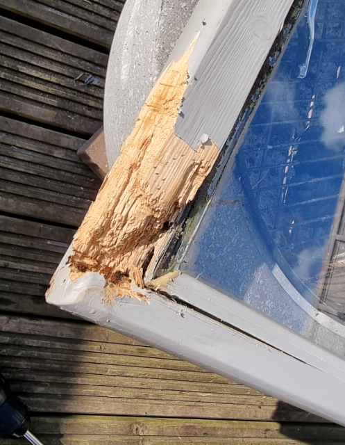

I have a double glazed top opening window that has rotted in the corner for a garden building. I don't think it was the best quality to start with. For now I can try to bodge it with hardener. I have removed the spongy bits and found where the good wood starts, but its marginal and I should have looked at it before now.
I'm not that old, but we used to go down the road and get a new frame made and just move the glass from the old one. I cannot find anyone anywhere near me that seems to do that anymore. Or I don't know what I'm searching for if I look on yell or whatever.
Who or what should I be looking for? I would have thought in 2022 you could probably find a website where you can simply put the measurements in and window appears in the post a few days later but I can't even find that.
The window in question.

Nope, seems to be a complete window. Very frustrating I don't seem to be able to find anything anywhere online or offline.
Its 72cm x 40cm opening. Double glazed.
Can I not just get wood of a suitable cross section? Again, since I don't know what its called I can't find anything.

Every window is unique in design, so there isn't a rigid standard that they are made to, making a web site approach for a casement a bit of a no-no. As to sending in dimensions, with respect I've learned to distrust any and all measurements taken by anyone other than myself or a trusted colleague because they are so often wrong, especially on something like this which needs to be millimetre perfect
At one time, as you say, there were a lot more small joinery shops, but these days the massive overheads of running a shop combined with a big switch since the 1980s to PVCu windows and doors and the advent of low cost CNC factory made stairs has taken away a lot of the bread and butter work and makes running a shop a fairly unattractive prospect unless you can get into a specialist market like sash windows, porches or bespoke kitchens

Yeah - thats pretty much where I started this thread. And I guess that is why they sell complete window units.
At the end of the day there is a hole in a wooden frame 720x400 that it has to fit in, it can't be that hard.
My other plan was find some wood close and maybe route it or something since we don't seem to have any joiners anymore. I'm a bit annoyed as the window is 5 years old, but the rain has found its way between the glass and the frame and its been happily feeding whatever ate my window.
But do they match the existing mouldings?
If I can find something that is close enough and doesn't cost £40 to ship then I can probably work with that.

it looks like a softwood sash for a summer house
its a stormproof style -ie rebated so it sits proud on the outside of the window frame and I guess fitted with cranked hinges
If you are handy with a router, you could make something to replace it
Most joinery companies wouldnt be interested -its hassle to set up for one sash

Ah, yes all terms I saw online and now I know what they mean!
I'm not handy with a router - how hard can it be? , I'd make a simple joint and then I just need to get a profile that nearly works.
(I'm not that bad, I have built and repaired aircraft wings)
