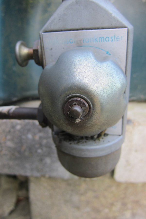

Hi I have a Worcester danesmoor oil boiler 15/19 boiler with a Danfoss BFP41L3 oil pump. I ran out of oil and have just had a new delivery. As expected I still have lockout. I read how to bleed the danfoss but the part I needed to bleed I couldn't turn the allen key. I know I've tried to turn the right part because I followed a danfoss video on youtube. Is there any other way I can get my boiler to start? thanks in advance!

Thanks again for the replies. The oil tank is higher than the boiler. However, the valve may be faulty at the oil tank, because when I turn it to try and turn it off it just keeps going round. I hope the pump isn't damaged because it's only a couple of months old.

That's an Atkinson Tankmaster.....turning the alloy wheel pulls a sluice and allows the oil to flow.
The wheel shouldn't freewheel in both directions.
The gauze filter is in the bowl underneath - which could be full of crap.

It freewheels to the right, but will turn to a stop to the left (open).
Was the valve closed when the tank was filled?
I'd be inclined to close the valve, and remove the filter bowl beneath.
Are there any more valves on the oil line.....maybe a fire valve where the pipe enters a building?
John :)
No the valve was open. As mentioned previously it just keeps turning when I try to close the valve. Therefore, I'm not sure it's really closed. No there aren't any more valves where the pipe enters the building.
