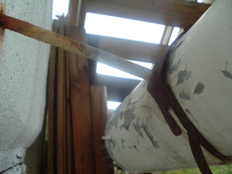

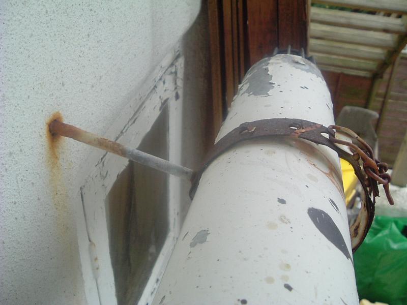

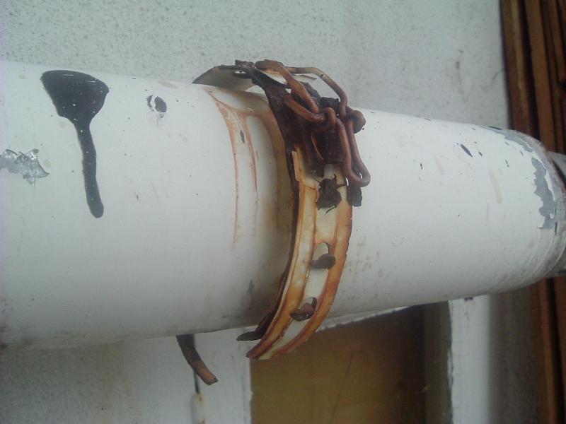

The flue is fixed to wall by a circular clip with 6"+ rod/pin going into wall.
This clip has rusted & broken on side away from rod/pin.

From these pics it seems to me that the bracket is the least of the problems. The flue termination appears to be illegal to me.
How about more pics from more angles?
This is a terrible lash up. Just the sort of thing one finds on 'buy to let.'
We can't see where the boiler is from the pictures but I suspect the flue couldn't be terminated in the proper way due to window proximity, so some joker has extended it outside using internal flue components and a piece of chain.
I expect you will end up ripping it all out and fitting a new boiler with plume management.

Only in last couple of years the flue has been put down to Not to Current Standards, it's been like that since 1995.
The boiler is in the outbuilding to left of flue.
In 1st picture the flue continues to left for about a foot before turning into this outbuilding.
My backdoor is a foot from that turn, there is a flat above with backdoor & stairs leading down which you can see in 2nd/3rd pictures.
