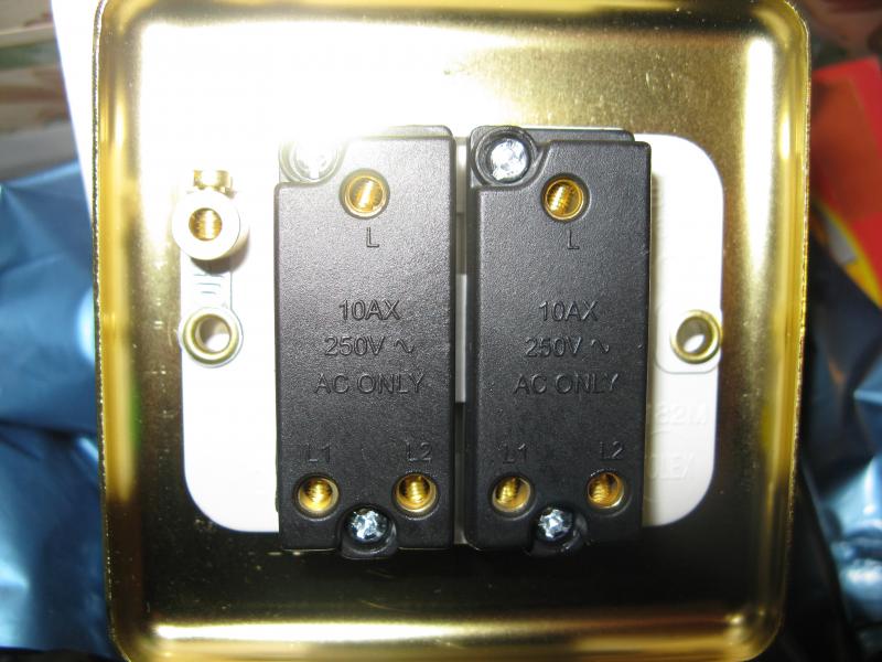

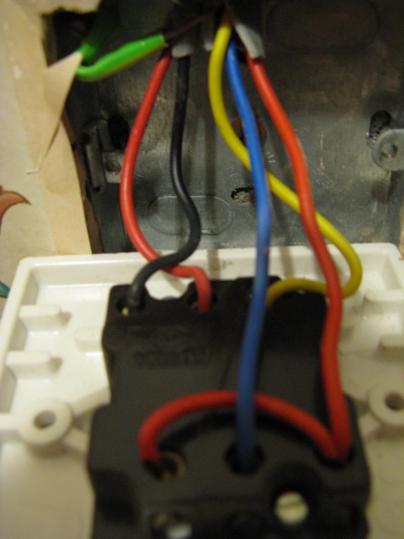

Hope you can assist bought new 2 way 2 Gang switch unclear as to wire the new one.
Old switch controls one hall light and two other lights top and bottom of stairs but as you can from picture of existing switch a link wire is used.
Advice on how to wire new switch please. Thanks in advance.

swap the switches over one terminal at a time, all terminals chould be marked, look out for
C / common
L1
L2
i suspect the link will go from one C on one switch to the C on the 2nd switch.

Is it the case on old switch the 2 Gangs are opposite directions compared to new one.
no it won't ... :rolleyes:
the link goes from the red in the 3 core and earth which is in the L1 ( or L2 ) terminal of one switch, to the common of the other..
your existing switch is 2 triangles, one upside down to the other.. ( as can be seen by the diagonal line on the back of the switch.. )
the yellow goes in one com, the blue from the same cable to L2, the red form the same cable to L1 ( and linked to the other com )
then your other cables go in L1 and L2 of the other switch..
and don't forget a link from the earth in the backbox to the switch plate itself..
Look on the back of the old switch.
Observe there is a line dividing the back into two sections (for two switches).
You will notice the common terminal is at one end on it's own for each switch.
The common is on it's own at each switch on the new switch too.

It may be quick and dirty, thats the best kind lol, many thanks it does the trick
Do I still need to earth the plate as the screws will connect the plate to back box
Yes.
Best to take the cpc to the box terminal, then another to the switch plate.
That way, it's all securely earthed even with the switch off the wall.
You must earth the metal faceplate with a flylead and not rely on the fixing screws, if the faceplate was loosened off for decorating etc, it would no longer be earthed.
