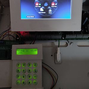

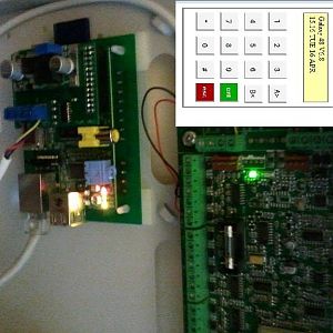

Galaxy Dimension with Raspberry Pi connected to serial port via an RS232 12V to 3.3V hat. The Pi then runs ser2net to provide a TCP based connection to the panel. Once you have that, you can run the free SelfMon Virtualkeypad Apps or HTTP server software from www.sm-alarms.co.uk
