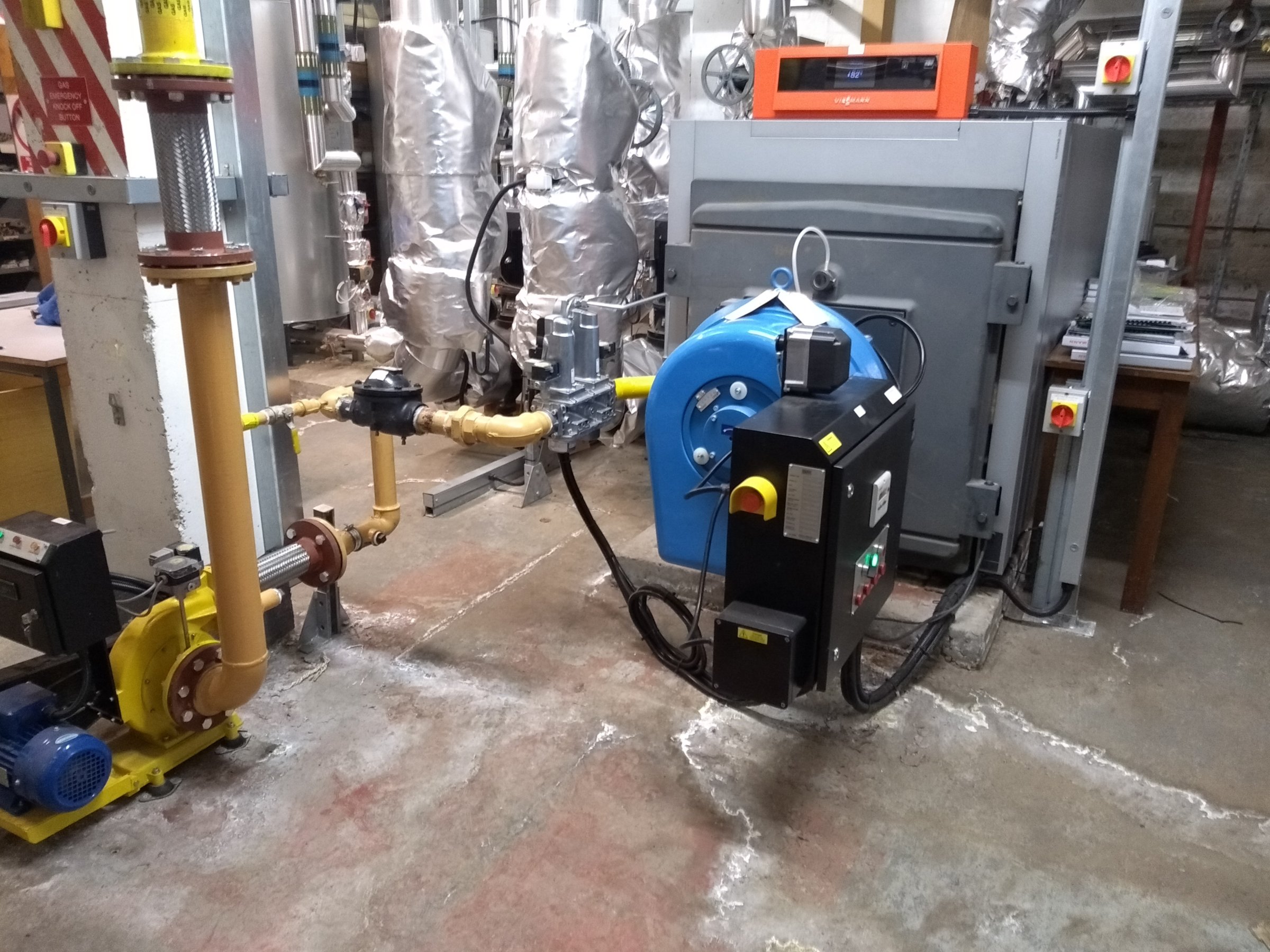

Lack of gas isolation valves, the flexible connector should be directly connected to the booster (the booster is gonna shake with that lump hanging off it.).
bad
