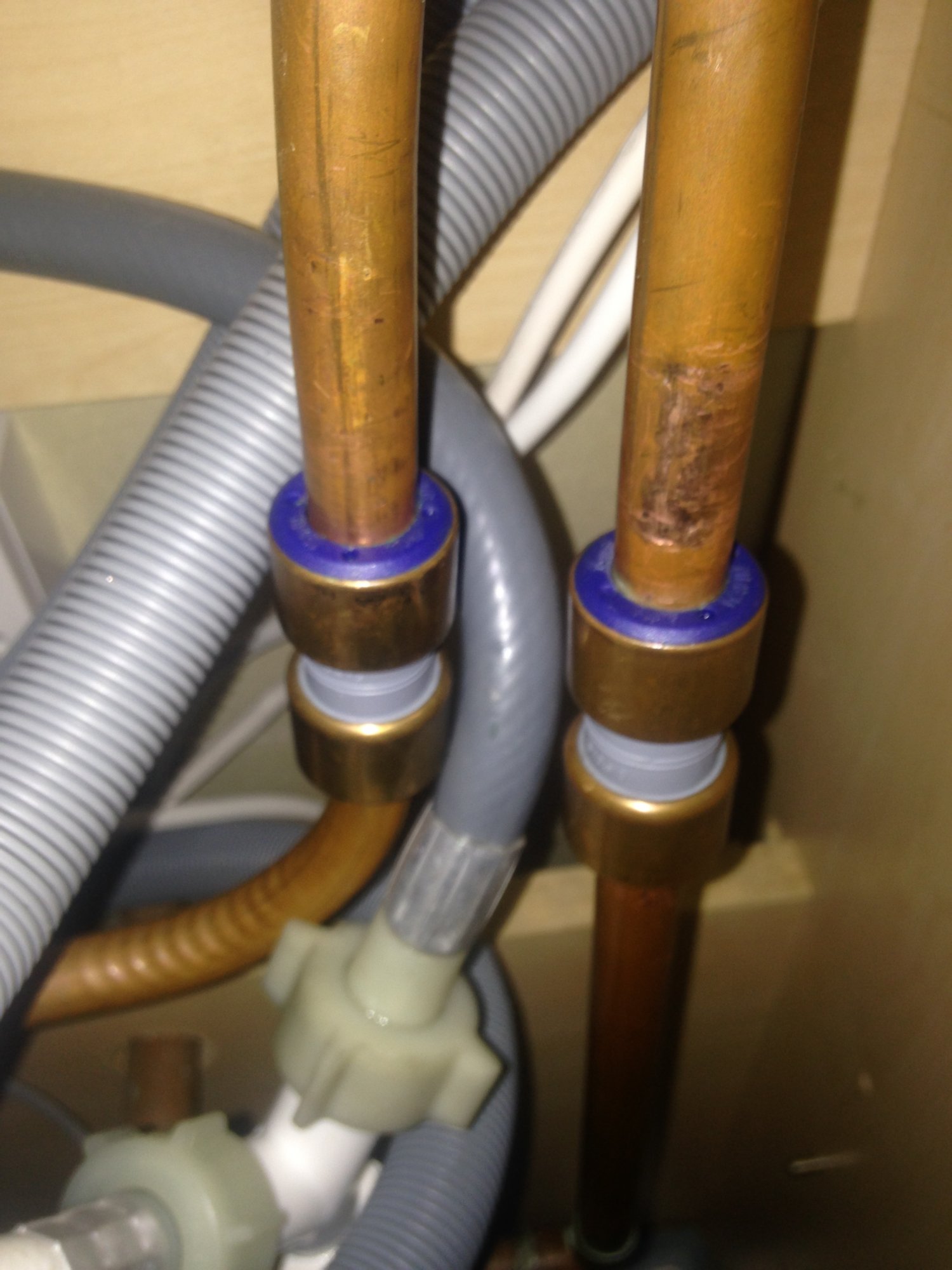

Push Fit or not
If you do cut them out and use new Pushfit fittings make sure the section of pipe that the new fittings go on isn't damaged otherwise the "O" ring may not seal correctly.
The copper pipe above the fitting on the right looks to have been damaged at some time.
