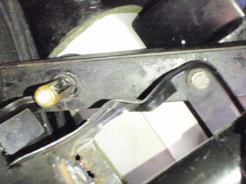

L Section steel bracket in place
  • Media owner deeeeps
The cable end can be seen to the left and the securing bolt to the right. This bracket was made longer, to allow more 'meat' of the bracket to press against the plate it was bolted to.
VW Polo Clutch Pedal Repair
