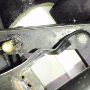

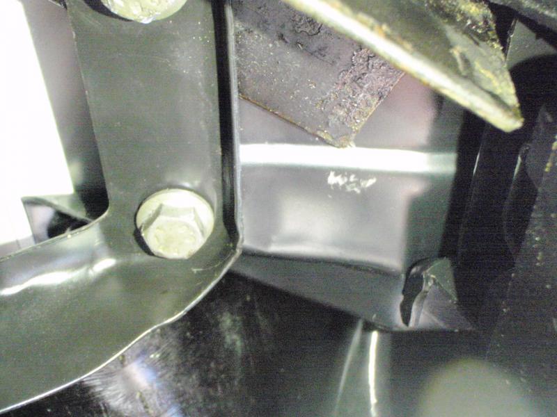

The other end of the  L cross-section bracket
D
At the top of the picture is the L cross-section bracket bolted in place between the existing pedal mount plate.<br>The other bolt was the existing pedal mount plate bolt. Once tightened, it assisted by 'pinching' the new bracket, helping prevent any lateral movement.
VW Polo Clutch Pedal Repair
