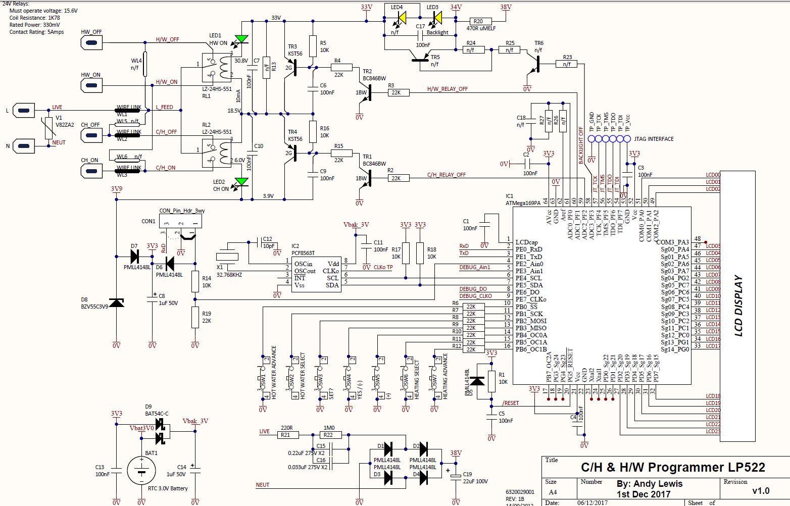

This circuit diagram represents my REVERSE ENGINEERING attempt at re-creating the schematic for the Central Heating / Hot Water LP522 Programmer
C/H & H/W Programmer Timer LP522
