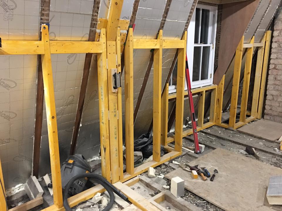

Rebuilt dwarf wall studs
  • Media owner iwilson16
The old studs were a bit flimsy, and attached to the side of the roof joists making it harder to fit the insulation. The bit in the middle is where the partition between the 2 rooms will go
