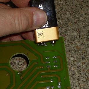

Applying a PP3 batteryto the two contacts of the motor control relay should cause an audible click-click as you connect the battery. This shows the relay is working properly
