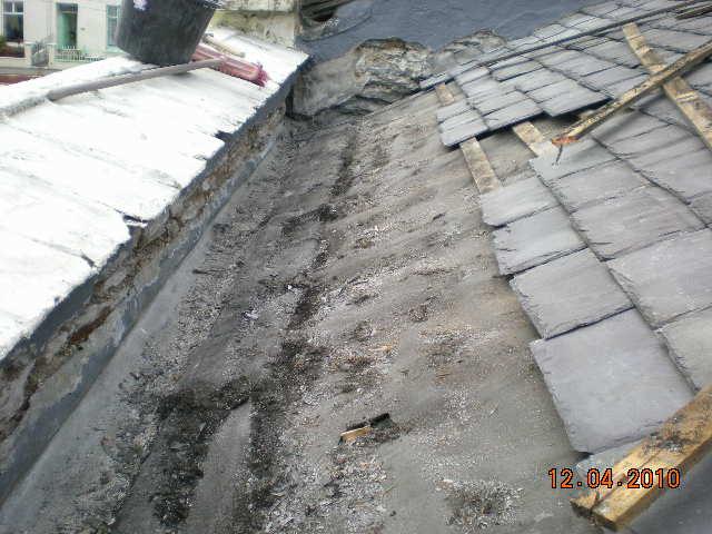

This is our valley after I ripped a few slates off You can see that slates have been laid on the parapet wall to deflect water into valley. A good idea but you can see the edges broken off the slates and the water has just been running down the parapet wall(which was cracked) and rotting the valley board and rafters.
