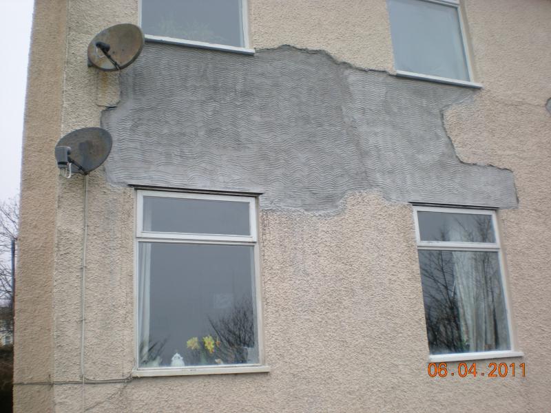

New lintols fitted in all the windows as the old lintols that were originally fitted 70 years ago were made on site and had hardly any cement in the mix and over the years they started to crumble and the dash started to crack. All cracks were meshed withs/s mesh and this is the first scratch coat to go on there will be another two before I match the dash in.
Patchin' dash....
