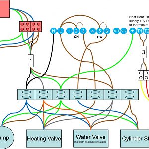

Wiring1
It all looks good to me. I assume that the brown loops between 2 & 3 and 5 & 6 represent the internal switching of the Heatlink and are not actual wires you plan to add.
Stem, yes that is correct. The loops between 2 & 3 and 5 & 6 represent the internal switching - it helps me understand the path through the wiring. Thanks for your comment
