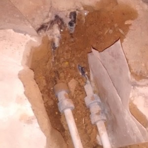

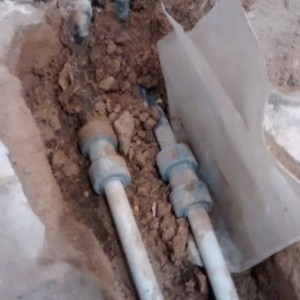

    Damp patch on concrete near to pipes
    Just spoken to the plumber and he can swap out the plastic with copper, but has advised that joining to the old pipe would have too much water left in to solder. So would need to use compression fitting. Which, to me, seems no different to what I have now. He has soldered copper fittings under...
    Because I was advised by the other plumber that this would be OK. Why use these type of connectors at all if they will leak?

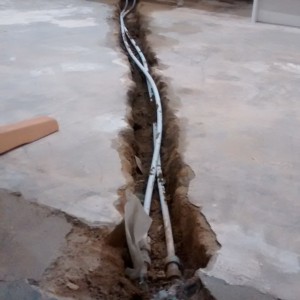

    Managed to get a decent plumber in to rectify the areas that I was concerned with. So all good now, thanks. Still have a PEX pipe in place as this was preferred. Now that it is all dry & no further leaks I'd like to screed over. Would a 4:1 mix of sharp sand and cement serve to fill in the...
    Thanks for your feedback on this, really appreciate it. I would be happier putting copper back in with a proper soldered joint & wrapped. Then the pipes would come in closer to the wall and the fittings could be done correctly. Just need to find a decent plumber to do the job now :(
    Apologies for the tardy response and thanks for everyone's replies. I've had a plumber in today to dig up the pipes as that seemed like the best way of checking. Appears that it was a slow leak caused by a hole/dent in the pipe on the hot feed. It wasn't where we expected, but due to the slope...
    It's definitely not the connections, checked these and they are all dry, unfortunately. Yes, on a water meter. I can't understand why it is isolated to one area though? Assume it could be a small leak in one of the two pipes? We did have a new combi boiler fitted a couple of years back. Could...
    We've recently had a new kitchen installed - Yay! ;), but have found a damp patch on the concrete floor - Boo :( The damp patch is located just in-front of the hot & cold water feeds, which are buried under the concrete. The pipes have been there for about 25 years (part of an extension), and...
