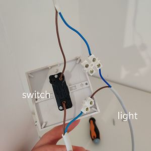

    Wiring push to break switch
    Great cheers for the advice. Given everything is plastic and the brown switch live sleeve is on now I have given it a test and everyone is working as it should.
  8. AdamEG
    The power supply feeding all this comes from a plug up in the loft which already had the cable connected and hanging into the wardrobe space (guessing they started thinking about lighting then ....didnt bother.....). Just dawned on me what I think you are saying here, should the cable supplying...
  9. AdamEG
    The push to break is positioned by the wardrobe door, so when the door opens the lights come on, the first switch is simply when someone stumbles in at 2am and doesn't want to wake up the wife with the wardrobe light (y) the light itself didn't come with any earth cabling or points to attach an...
  10. AdamEG
    Hi all Looking to wire 2 switches; one as a "master" and the other a push-to-break going off to a simple led light. How does the wiring look in the attachment? Not done it in a long long time! IMG_20200112_140653__01 by AdamEG posted 12 Jan 2020 at 2:15 PM
