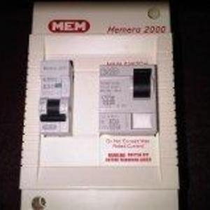

    electric shower not working
    Sorted - many thanks

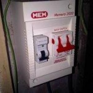

    the 1st picture shows the cu as it is, but I need to replace the right hand side as the neutral line is not working. The 2nd picture is what I want to replace this with - part on the left is the original (straight swap) part on the right is a 80A rccb - hope this makes sense.

  8. A
    I have rewired the whole cable run in 10mm - still not working. However when I looked more closely at the Memera 2000 cu - I found that the neutral side had gone completely. The switch that is now burned out was a 63A pod - I have a spare rccb rated at 80A, can I use this or will I have to...
