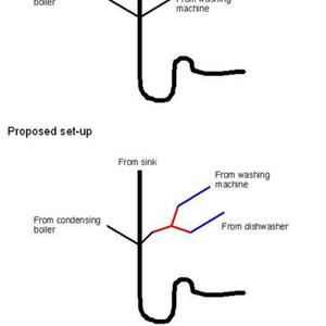

    Plumbing waste for washing machine and dishwasher
    Thank you for the replies. Don't think there is enough length in the vertical piece before the u-bend/trap to install another T-junction with spigot. I'll give the second option a go, i.e. dishwasher and boiler condensing pipe via non-returns to y-connector to 1st spigot and washing...
    Thanks Richard. Fixed the link to the image so you should be able to view it now. In understand your point regarding syphoning, but wouldn't the non-return in-line valves prevent this? I also note your point on running the condensing pipe directly to the outside. However, as we live in...
    Hopefully my diagram has uploaded correctly - it will make the explanation a lot easier. I currently have a condensing boiler drain pipe and a washing machine waste pipe connected via separate spigots to the pipe which drains the sink. This arrangement is shown in the upper diagram. I'm...
