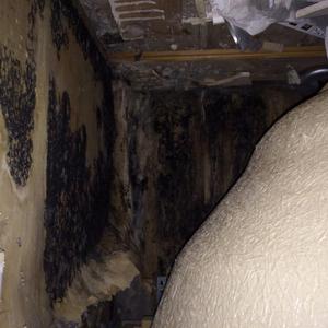

    Paramount board and rot.
    Good evening guys. I'm looking for some advice regarding a project I have under taken and any help would be most appreciated. I recently bought my first property, after a week my mother in law pointed out the big bow in the kitchen roof, so we went into the bathroom upstairs and found...
