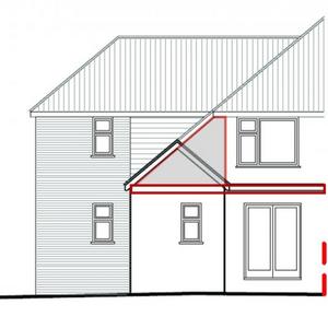

    Question about support when creating an opening of 5.4m
    Ahhhh a beam lifter, just did a google image search, like a giant trolley jack. Perfect. I was looking at Genie lifts but they are bulky and expensive to hire. 1 beam lifter at each end and we are laughing. Thanks for the suggestion. Regarding the rebuilding of walls. One side is being...
    Bolt grades are the higher 8.8. Because of the loading on the beam and the walls not being too great, he's specified that the beam be supported by UC's at either end buried in the walls. I've also got to dig up and put new foundations in but I'm waiting on those drawings early next week. He...
    Right the SE had specified a 203 UC 71 with my point load beams bolted to it. This leads me to my next question. On the drawings he has specified a 10mm thick mild steel end plate welded to one of the adjoining beams. It also says F.P.F.W + 4 No M16 bolts. What is F.P.F.W?
    I did ask him to specify a couple of parallel flanges that could be bolted together once in to aid maneuvering. There will be another point load on this beam from another beam that will support a 1st floor wall. Bascially building up from that little pitched roof section at some point this year...
    Most of the jobs I take on a small-ish jobs. In the past when I've had larger work come in Ive subbed it out as my workforce was only small. Now that we are a bit bigger I wanted to take on a bit more for myself. All the beams I've ever put in have either been during a new build state or not...
    This is a little unusual for me and just wanted to hear out a few other more experienced builders than myself before attempting this. I've got a 5.4m opening to create in a 9" brick wall. Haven't chipped off the render yet to see if the mortar is decent or not so cant tell you that yet...
