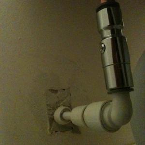

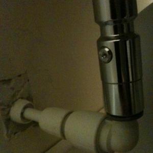

    Best way to extend this toilet water inlet pipe?
    Hello all, I am trying to extent my downstairs toilet pipe inlet. Its a newbuild house, and I have just put laminate flooring under the toilet, which means its about 1.4cm higher than it was. I have attached pics in my album. There is a plastic pipe coming in from outside, which leads to...
