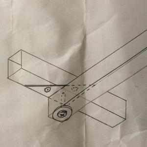

    How to make screw fit snugly in a hole
    I don't have it on me but here's a drawing. It might make it clearer now, if the screw in the middle is too small for the hole, then the two box sections can pivot arround the screw a little but, until the screw hits the edge of the hole.
    Hi, I've made a T-joint recently between two sections of aluminium box section and I rivited a sheet aluminium triangle between them to try and prevent rotation, with two rivets in each corner, and a machine screw actualy through the two aluminium box sections. While this did a good job at...
