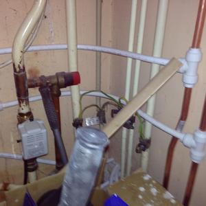

    Quiet shower & bath pump
    Hi Dan Plumber is here at the moment so can't take a photo. This is my airing cupboard so I also have solar panel pump and pipes as well as central heating. I really hope this isn't a mess as the plumber is trust mark and wras accredited. Will post picture later. Thanks
    Hi - have now put a link to the photos on my post above - so if anyone has any suggestions I would welcome them. Ann
    Thanks - I have taken a couple of pictures but not sure whether you will make anything out. The white pipes are for the pump - but very confusing in there with solar panel piping and central heating pipes - really is a labyrinth http://www.diynot.com/network/annc1/albums/
    Thanks for your help - I have looked and seen that the pump is a stuart turner shower mate eco 1.5 bar - situated on airing cupboard floor with 10mm anti vibration mat underneath. As I said before the noise is deafening. When it was first turned on I thought someone was drilling more holes in...
    Hi - would be grateful for some advice please :) I am having a new bathroom fitted and the plumber has fitted a pump for the shower and bath - A Stuart Turner one which he said cost £146 - but the noise is like a pneumatic drill - the whole house vibrates even though it is on an anti...
