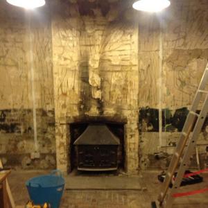

    Chimney breast questions
    Hello, I am in the process of insulating the walls in my kitchen and am wondering what to do with the chimney breast. For the main walls I am adding furring strips with 25 mm insulation in between and 25mm insulated plasterboard fixed on top. For the chimney breast can it be plasterboarded...
