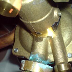

    Alpha CB28X Diverter Valve Leak
    Thanks to all for your good advice. Sounds like there is a good reason for the hole to be there... I think I will live with the weeping for the time being and get a plumber if it gets any worse or causes any other problems. Cheers, Ash
  2. A
    Hi Tony, Thanks for the reply. The boiler works fine so far. Its only about 3 years old. A 5mm LED wrapped in PTFE seems to fit perfectly...It seems to do the trick on the short tests that I have done. Don't want to cause any more serious problems though... Ash
  3. A
    Hi, I have an Alpha CB28X that has developed a leak from the bottom of the diverter valve assembly. The boiler works fine except for this. The leak is constantly there, but has gotten worse recently (steady drip). It drips faster when a hot water tap is turned on. Looking at the...
