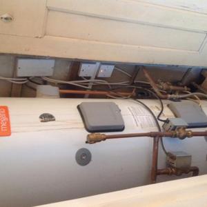

    No hot water in the morning
    Okay pictures uploaded. I can send more if you need. http://www.diynot.com/network/asperity/albums/ I would understand if it was one shower but for both to fail seems a bit too coincidental.
  7. A
    okay, trying again with this problem. I've had a plumber round who told me there was nothing wrong, just leave the hot water on continuous and then there will be hot water in the morning. I did that and its not work. The good news is that it wasn't a complete waste of time as I understand more...
  8. A
    thanks when did it last work ok? up until a couple weeks ago What has changed? i dont know! it has gotten colder. the only thing that has happened of significance was that over the summer we had work done in one room which meant that they had to remove the radiator. That led to the...
  9. A
    I have a 3 year old Worcester 30 combi boiler, as well as a megaflow, closed system. There are 3 of us in the house. Our heating and hot water is controlled by a Honeywell Timer which seems to be working correctly. The hot water is currently set for 0530-0800 and then 1800-2100. It was set...

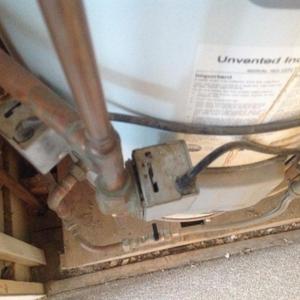

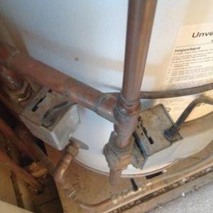

    Pressure at Zero, Worcester Greenstar 30cdi
    i am going to contact the manufacturer (Aeon) about the bleed nipple in the morning. It does seem weird. BUT in the meantime, i turned the handles on the valves, and the pressure has gone back up to 1 on the boiler. I couldnt actually see a pressure valve on the megaflow, but there are a...
  13. A
    aha!! thank you i am going to try this and see if i can get it working. will report back
  14. A
    yes that is what it looks like. its just positioned in a way which means that the screw head (nipple?) is at the bottom, which meant that its worried me that i didnt get it back on right. in the meantime, i have ordered a worcester key from the web, im just concerned about whether its...
  15. A
    what im trying to understand though is whether, as an unvented system, it should definitely have a key, or whether i should be turning a valve to get the pressure up.
