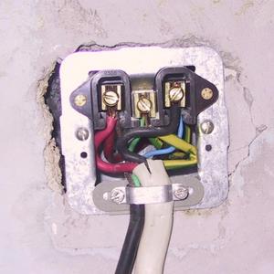

    Induction hob wiring
    Yes, the manual specifies 2.5mm for connection via a socket outlet, but the consensus here seems to be that anything over 1.5mm is overkill and also awkward to wire into a plug. Presumably the same dilemma applies to the length of flex connecting the connection unit to the 13a socket on the...

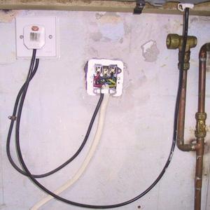

    So if i understand you, what i propose is fine?
    I haven't bought the hob yet, but the oven is rated at 2075W. Do you happen to know what size/spec flex it will need? It will, as you see, go into the same outlet, albeit via a 13a plug/socket. Edit - just saw on the oven spec - min 2.5 mm 3 core butyl insulated. Any way to check what the...
    Hi - thanks for the response. But it was the old 6mm oven cable that i intended to use for the induction hob - the gas hob flex would be used for the oven.
    I have a DP cooker switch running to a cooker connection outlet via conduit 1m away under the worktop. This outlet currently has a 6mm cable running to an oven with a total rating of 2075W and a flexible cable running to a wall socket. The gas hob is plugged into this socket with a normal 13a...
