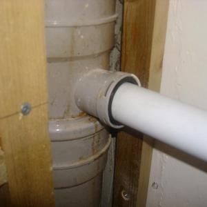

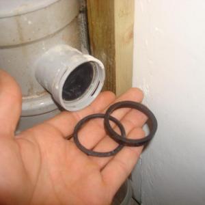

    Leaking boss waste (not strapped)
    How do you mean 'graft' the O-ring and collar over - Just swap them out?? I don't fancy it but the silicone or denso tape may be the last resort! :cry: Whitespirit66 - It is reasonably snug but not as snug as i'd like which i think may be part of the problem? I may see if I can get a...
    Hi Hugh Jaleak, It is a Marley Push fit Boss, but I would say your description of the plastic socket and O-ring is what I have rather than the rubber 'plug' type. Which is why I had concerns over the adaptor suggested by Dextrous not sure if it would fit the Boss I have?? Similar to...

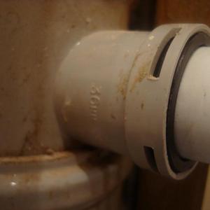

    Thanks BingoBongo, It slides in relatively easily without grease (steady Dextrous), which I think may be the problem?? The O-ring appears fine. I've just noticed the Boss has 36mm stamped on the side and i'm using a 32mm pipe could this be why its leaking?? Pipe too small?? Or is that just...
    Thanks Dextrous for your speedy response. Would that adaptor work if the boss is not a 'strap on' version??

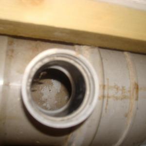

    Hi all, I have recently re-furbed a tired bathroom and am quite impressed with the result. :o However i have just noticed a leak which eminates from the basin waste / soil stack boss connection. :( The boss is an 'in-line' version ie it is part of the stack and not a strap on version...
