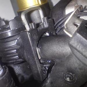

  7. B
    Glow Worm Boiler small leak
    Just to let you know, I couldn't fix this myself as I didn't have the time or tools. The engineer took the assembly block apart and just replaced it all with new bits. Bloody nightmare really, crap boiler!

  9. B
    Hi, I'm hoping someone can help me. I have a small leak in my GlowWorm 24cxi boiler. See the photo: And to help (maybe) I've included a photo of it's rough location: So water is coming out with a hiss (at some pressure) at the bottom of where that component joins(?) another . I...
