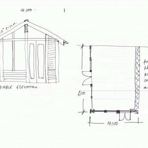

    Glulam Ridge beam help
    any comments much appreciated!!!!!
  6. B
    hi newbie post please be kind!! we are planning a garden room sketch attached. looking at using a 90x315mm glulam as a ridge beam which gives 1.27t as a uniformilly distributed load...is this enough? roof is tiled approx 6.2lx4.1m width using 150x50mm rafters and ridge beam support post...

  8. BB sketches
    BB sketches
    ridge beam sketch
