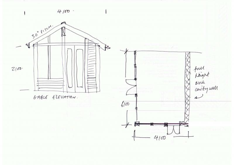

we are planning a garden room sketch attached.
looking at using a 90x315mm glulam as a ridge beam which gives 1.27t as a uniformilly distributed load...is this enough?
roof is tiled approx 6.2lx4.1m width using 150x50mm rafters and ridge beam support post would be 150x150mm eaves beam/wall plate 150x150mm. glazed on 2 sides with block along 6.2m length..
can you forsee any major problems? would prefer to keep the roof vaulted without a ceiling...any help much appreciated thanks
