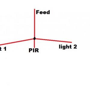

    Hi folks, The black 'blob' in the diagram is a junction box - kind of. At least that's where the four cables converge and are wrapped in electrical tape. I think it may actually just be connectors rather than a junction box. From the 'blob' there's three cables. One to a light, another...

    Thanks for the reply I've tried to upload an image - David Bailey I ain't. I've in fact uploaded a diagram of what seems to be happening: Live feed > connector covered in electrical tape > three cables coming out of this mess > one to light one, one to light two, one to the PIR. Don't...
