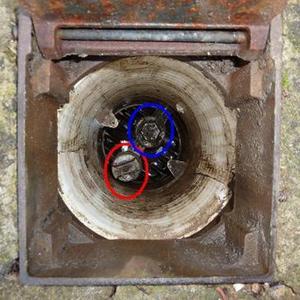

    Worcester Bosch banging noise when DHW cold inlet presurised
    Wahoooooooooo! This morning went outside and fully closed the stopcock then opened it back up. It appeared that when opened (about 360 degrees) you could keep turning anti-clockwise but it would not increase the flow rate. Therefore closed it again and opened it again to about 90 degrees...
    There's only one pressure reading and thats on the closed CH system. It reads constantly at 1 bar unless I turn on the CH and then it can rise to just above 2 bar so nothing unusual there and it drops back down to 1 when the heating is off. I plan to reduce adjust the stop cock outside...
    Thanks boilerdoktor. No water meter but about 2 months ago I turned off the mains water supply to the house from the stop-cock on the street to repair a pipe to the downstairs loo. Turned it back on and everything was running fine. I didn't mark the position of the stop cock before I...
    Thanks ChrisR. Firstly...I have turned back on the DHW cold inlet back on in the boilder. To answer your question....if I run the cold (or hot) water taps whilst the WC or other appliances are filling up, when they shut off there is no bang from the boiler. If I then gently close off the...
    A problem strarted occuring a week or so ago and is as follows : Whenever the cold mains water supply re-pressurises (e.g. after the washing machine, dishwasher or toilets have finished taking in water) there is a banging noise followed by some pipe rattle upstairs. At first it was...
