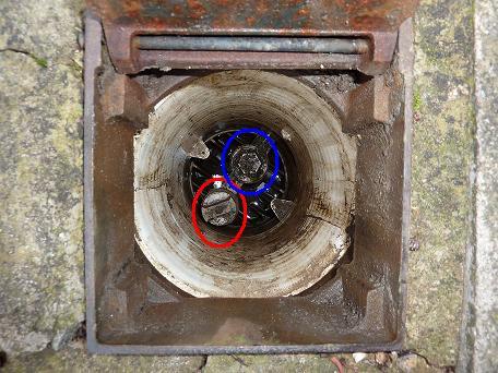

I plan to reduce adjust the stop cock outside tomorrow (in daylight) to see if this resolves the pressure problem with the DHW cold inlet.
Wahoooooooooo!
This morning went outside and fully closed the stopcock then opened it back up. It appeared that when opened (about 360 degrees) you could keep turning anti-clockwise but it would not increase the flow rate. Therefore closed it again and opened it again to about 90 degrees. This produced a flow rate of roughly 7-8 ltrs per minute.
This stopped all the banging and pipe shuddering but the flow rate appeared too slow. Then opened it to 0 degrees. The flow was now very fast and produced the banging again. Then closed it back to 70 degrees (as shown in the picture).
The flow rate is now roughtly 12 ltrs per minute which appears more than adequate for the boiler, dishwasher, washing machine and taps.....and no more banging :)
I guess there's a moral to this story. ....when adjusting the stopcock either ascertain the current flow rate or mark the stop-cock positioning before doing so. I'm just suprised we didn't notice the banging many, many weeks ago.
Many thanks to all who have helpded.
btw - anyone know what the thing is circled in blue?
