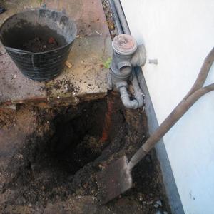

    I currently have one ground floor wc at back of house in bathroom. 110mm wc waste goes straight out through external wall in to branch with bath, sink and shower into it too. No stack, just capped branch at ground level. Then waste runs down 800mm into 90° rest bend and away to sewer. I am...
  7. proposed soil setup
    proposed soil setup
  8. existing soil setup
    existing soil setup
    new soil stack to be 80cm to right of existing branch
