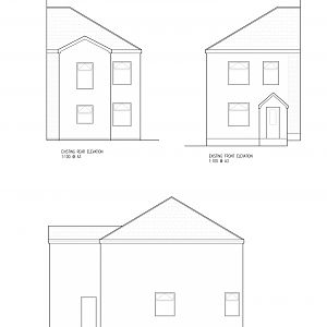

    Believe it or not, I thought it was allowed under permitted development especially after having an application from building control approved. Since it's a 2nd story extension, is there a difference in the application? What should I do?

    Lowered the floors to create room for a 2nd floor. Application from building control wasn't an issue. Most of it has been done. Missing is the window and cream render to blend with the rest.

    original by blhn posted 17 Mar 2021 at 12:25 PMproposed by blhn posted 17 Mar 2021 at 12:25 PM

    Hi guys, Hoping for some advice. I'm Kind of lost. The work was in progress so kind of in limbo. I received the following reason from the council awhile ago. “The proposed extension would, by virtue of its flat roof, and eaves height, appearas an awkward and alien addition to the application...
