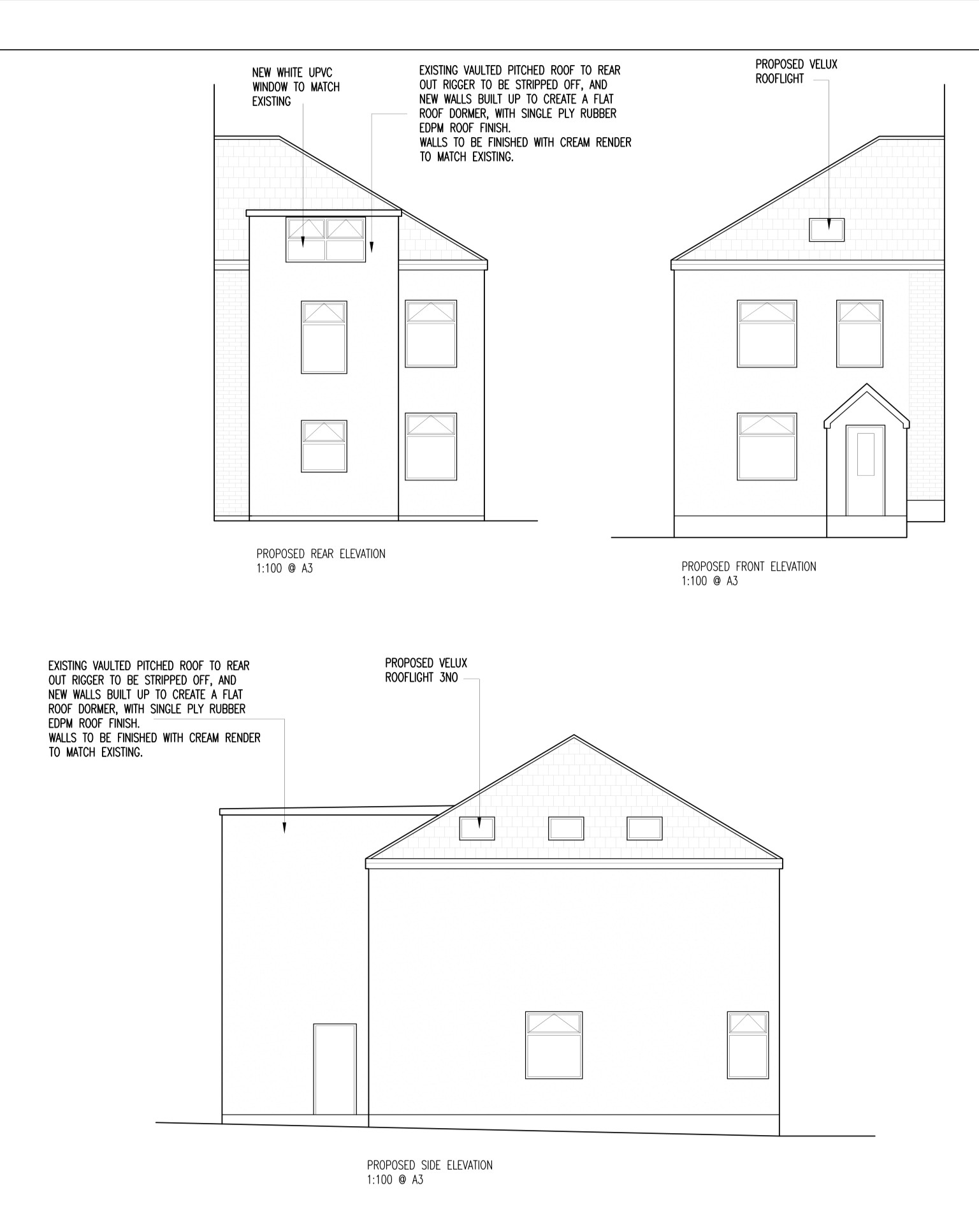

Hi guys,
Hoping for some advice. I'm Kind of lost. The work was in progress so kind of in limbo.
I received the following reason from the council awhile ago.
“The proposed extension would, by virtue of its flat roof, and eaves height, appearas an awkward and alien addition to the application property which would have adetrimental impact upon the character of the application property and that of thewider area. As such, it woud fail to accord with the visual amenity aims of policies 9and 20 of the Oldham Local Plan and the National Planning Policy Framework”
I’m looking for any helpful advice.
Redesign it in accordance with the planning policies
Redesign it to be permitted development (including check that it is not already)
Appeal

The only info was the one I posted. No other reason was given.

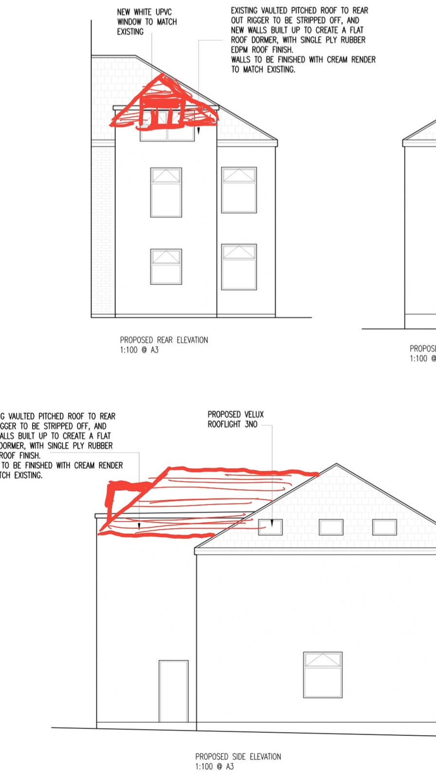

Redesign it how? All rear dormers look the same.
OMG that's awful. Even my firewall rejected it.

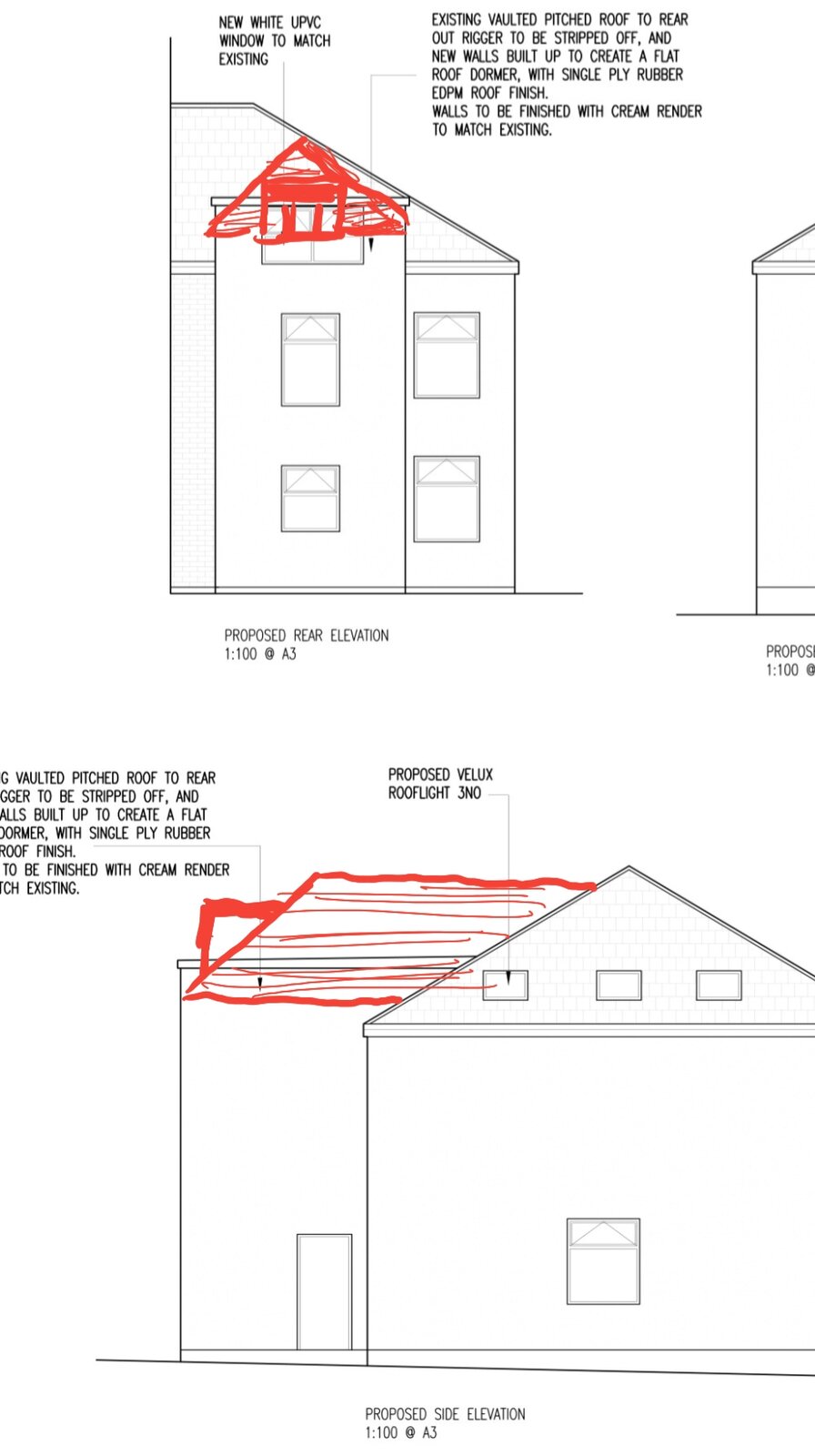

How about

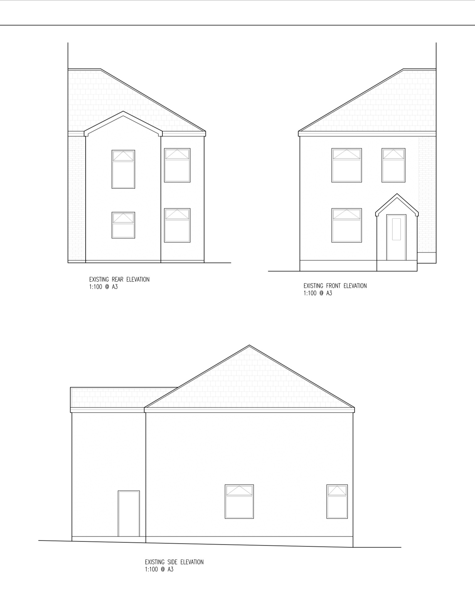

looks like a 3 storey extension? So won't come under permitted development - and PD rules don't apply in conservation areas - might not be, but that response hints at it.
How much of the build has been done already?

Lowered the floors to create room for a 2nd floor. Application from building control wasn't an issue.
Most of it has been done. Missing is the window and cream render to blend with the rest.
That is not a rear dormer! It is a second floor extension. No wonder it was rejected it is bloody terrible. o_O
Why on earth did you start work before you had received the planning decision? Anyway Woody's idea is about all you could salvage from the wreckage but for the amount of useable space you will gain I cannot really see the point.
A nice simple hip to gable conversion to the main roof would have been better.
