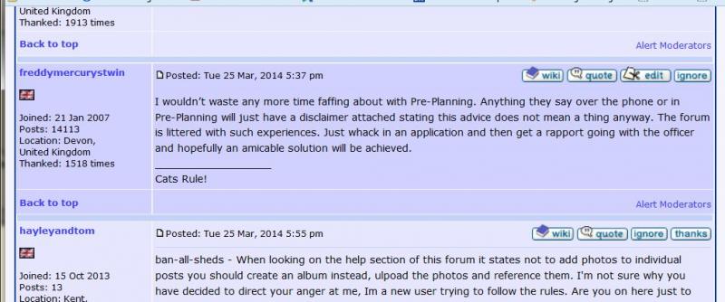

Pre-App is generally a waste to time and money for a domestic extension unfortunately, some more proactive designers would not say to waste your time and money with it.
You are much better off just putting in a really good application and then negotiating with the planners along the way to see if a compromise can be made. If you employed someone to do your application did they contact the planners along the way to see how things were going? If not they should have done.
I cannot pretend to a lack of bias. That said...
The pre-app has its place, but generally, for projects for this size and scope, it's a complete waste of time. This kind of volte-face by Local Authorities - even by the same officers - is not uncommon. The primary purpose of the Pre-app seems to be to give local authorities more time to think about why they might like to refuse a scheme. For this reason, I usually advise my clients against this process.
However, don't take the refusal at face value. Even where it seems hopeless, often a calm and measured conversation with the officer can result in a path to an acceptable scheme emerging - sometimes with what seem to be very modest amendments to the original proposal.
If this is the case, then make the amendments and resubmit under the 'one-free'go' policy.
