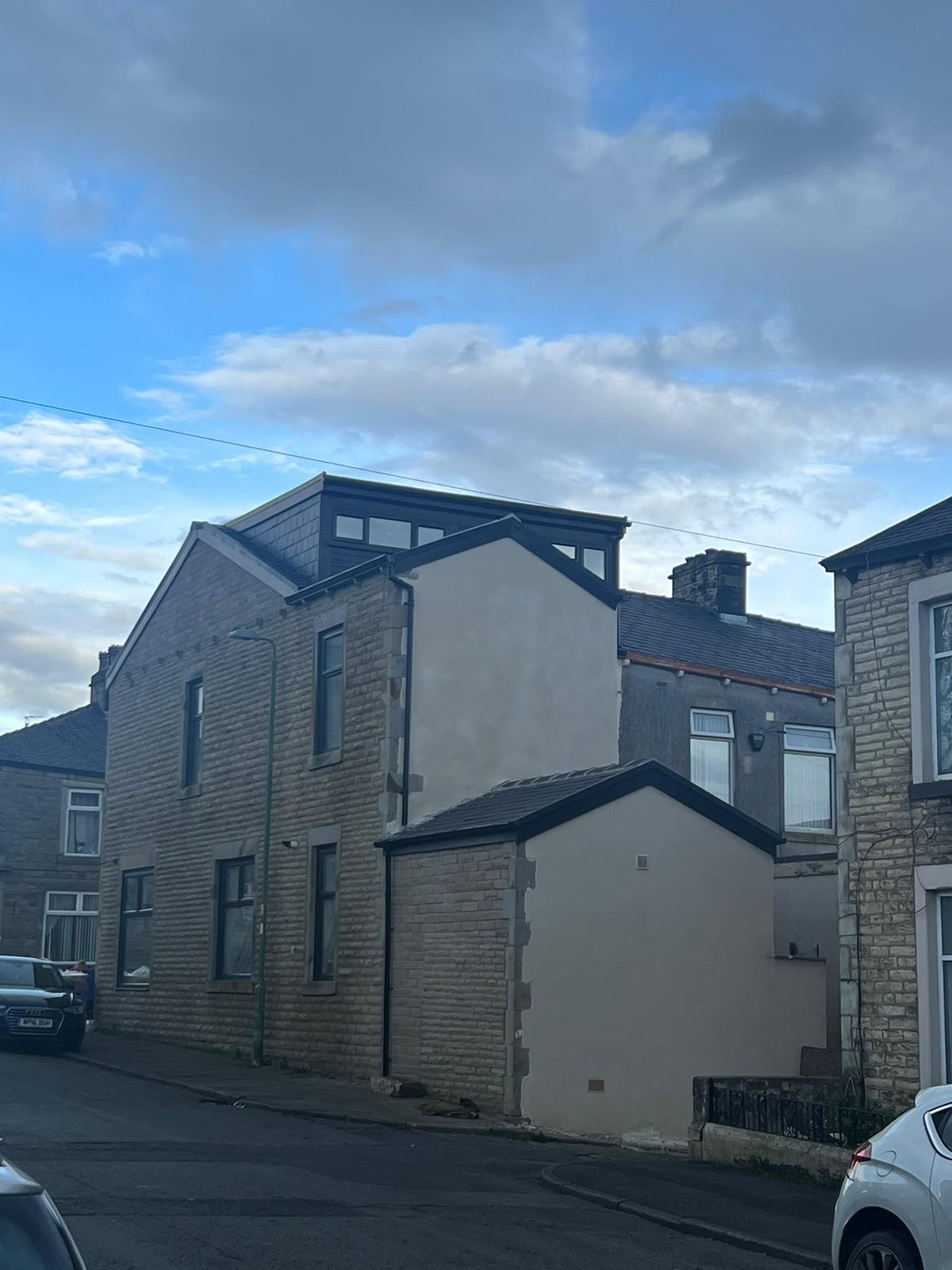

Hi
In a pickle if anyone can help with advice
terraced property with a hip gable and a rear double extension which was with the original house.
converted hip to gable and built the rear dormer under PD fully finished when the planning officer turned up and stated that because the dormer is above the outrigger of the rear extension it is planning permission required.
quite confidently submitted the plans and got refused for the reason below:
1. By reason of its design, size and position the Hip to Gable Dormer conversion with chimney removal (as built and as so described in the application) adversely affects the appearance of the host dwelling house, the terrace in which it is sited and the street scene, and, would be detrimental to the character, local distinctiveness and sustainability of the area generally. This would be in conflict with policies Env6 of the Core Strategy, DM26 of the Development Management DPD and the Householder Design Guide of Hyndburn Borough Council.
No mention of the outrigger in the refusal etc
My understanding is this development comes under PD. Is this worth appealing to?
regards

To the best of my knowledge you can build an L shaped dormer on the rear roof slope and outrigger roof under permitted development provided it meets all the volume, height, materials requirements.

Im suprised the PP was refused because everything is within PD guidance. The enforcent officers argument was that the dormer is built above the outrigger. The outrigger is about 3ft about the eaves.

If the planning consultant says it is PD and they have seen the drawings (unlike us) then submit a lawful development certificate application.
Out of curiosity why did the designer who submitted the planning application say it wasn't PD. Simply being above the outrigger does not make it not PD, there must be something else, volume, distance from roof edge, height, windows etc.

If you appeal a planning decision then it will only get assessed on the decision in context of the local planning policies and the process followed. So even if the work is PD that may not be a relevant consideration for the inspector. There are arguments that work which would otherwise be PD should be approved, but it's not always guaranteed that argument will sway an inspector.
If you are confident that it is PD then you should apply for a CLD, as then the decision of the planners is purely one of "yes it is/no it isn't", so if it is PD, a certificate is given and the work is lawful.

But this still doesn't resolve whether or not the work actually is permitted development or not. You say you have been told by a planning consultant that it is PD but as you have chosen not to share any drawings or photos we are all in the dark. I really don't know what you expect us to say?

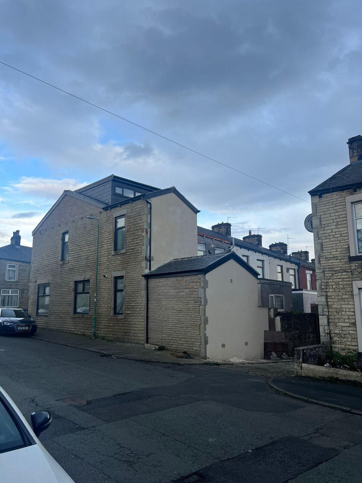

Please see attached proposed drawing to see what you think
