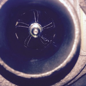

    Just to let anyone know using this for reference. The replacement turbo did the trick. Thanks for the help burnerman. One final question, do you think it's essential I change the oil to check the sump for metal shavings from the old turbo? This was recommended to me but I have done this a week...

    Needed a screw driver to free them up, once I did there were still some very hard spots. The photo seems pretty conclusive too. Image by Bowsh9 posted 7 Sep 2015 at 3:54 PM I guess it's a new turbo then.
