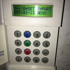

    ADT Galaxy 8 Plus
    Above is what I'm seeing ? Appreciate all your help guys :0))

    ADT Galaxy 8 Plus
    It won't let me enter 56 as an option? Only allows 1 to 13 ?

  13. B
    ADT Galaxy 8 Plus
    Thanks Neil. How do I get to option 56 from the menu ? Do I just enter 56 instead of 13 to get into that menu?

    Hi I have a Galaxy 8 plus alarm which in unmonitored. It was working fine until about 4 to 5 weeks ago when a BT engineer done some work on our phone line. It kept failing every now and again with comms failure (Call ADT code xxxxx). I guess this was because it could not connect to the phone...
